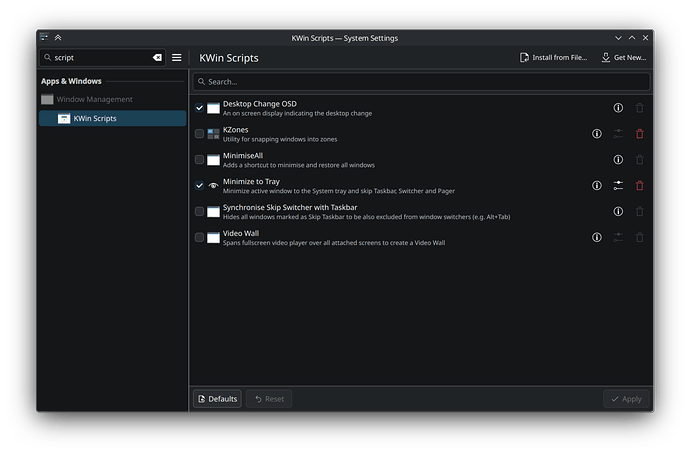

It’s possible with the aptly-named kwin-minimize2tray, but you will have to compile it yourself. I managed to get it working literally just now, so I still have the steps fresh in memory. I can’t say whether it runs well yet, mind. Just that it seemingly works.
I built it using a Fedora distrobox and I’ll assume you have one too. I do not recommend a distrobox with Arch here since their Qt libraries are more recent than ours, and thus the compiled files won’t work.
distrobox enter fedora
sudo dnf update
sudo dnf install g++ extra-cmake-modules libplasma-devel kf6-statusnotifieritem-devel
Clone the repo.
git clone https://github.com/luisbocanegra/kwin-minimize2tray.git
Build and install.
cd kwin-minimize2tray
./install-immutable.sh
If it aborts with any error regarding missing libraries; apologies. Google the error to find out what developer library to install.
Finally create a file ~/.config/plasma-workspace/env/path.sh with the following content;
export QML_IMPORT_PATH="$HOME/.local/lib64/qml:$HOME/.local/lib/qml:$QML_IMPORT_PATH"
Log out or reboot.

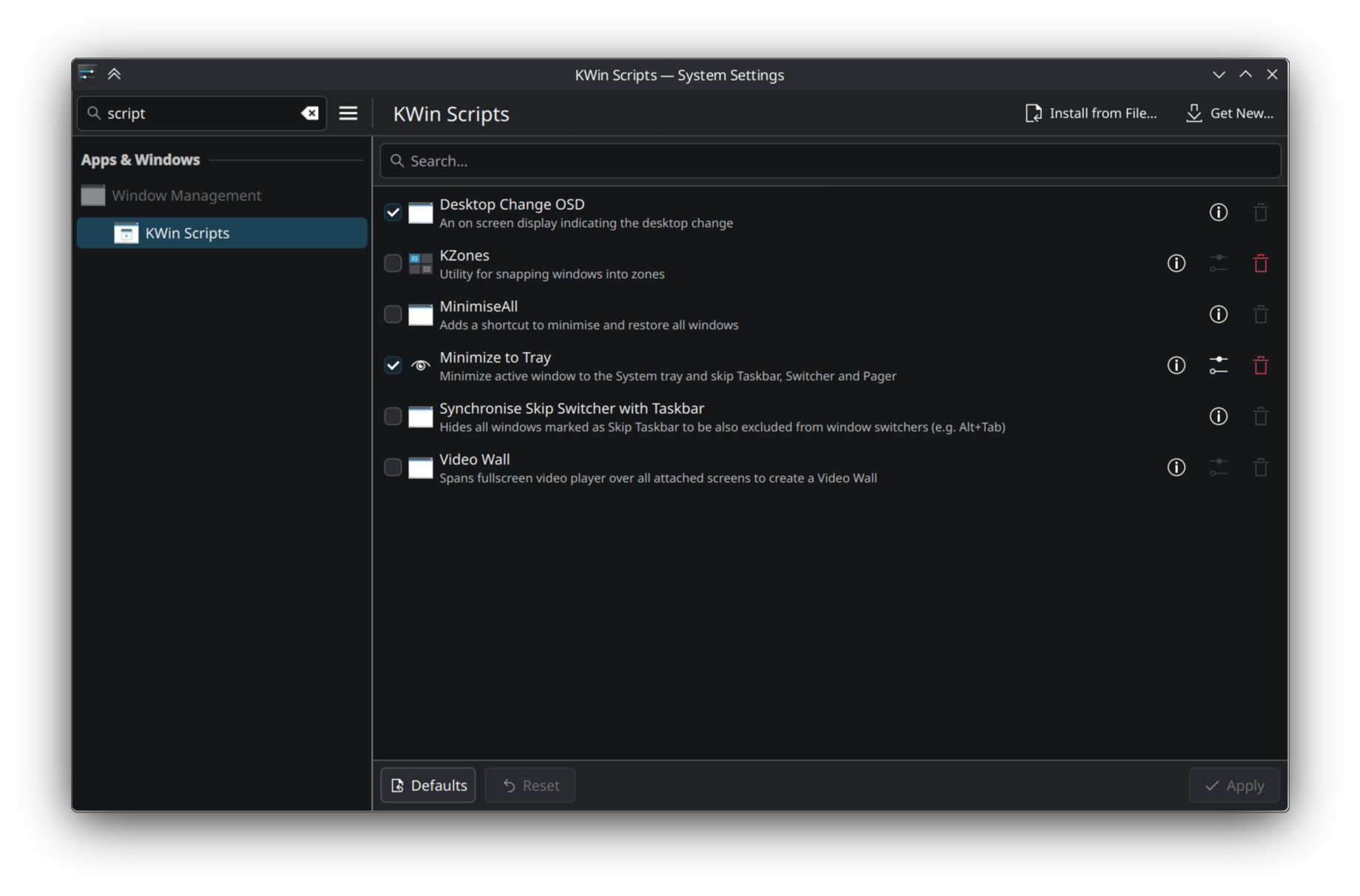

There should now be a Minimize to Tray script under the KWin Scripts section of System Settings.
There should also be a new shortcut available to set in the Shortcuts section; the default is Alt+Win+PgDn.
If the shortcut doesn’t appear, double-check the path.sh script for errors. You can also check the systemd journal.
