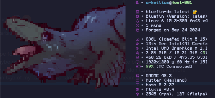

I have a problem on bluefin, when on high cpu or ram usage the entire desktop frezze and i must reboot to fix it (ctrl+alt+f3 not working)
What strange is that happen even with extensions disabled. And I’m already had this problem on my previous laptop and with other distro that use gnome (i didn’t try on KDE) but i don’t see much people having this problem online
neofetch
gnome-shell log of freeze 1
