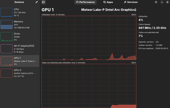

I am using Firefox and even though everything seems ok (have the flatpak packages, have enabled GPU acceleration in Flatseal, checked about:config and got the green boxes for enabled) I am concerned about the fact that it still seems to not use the GPU.
Here is my Firefox showing Hardware codecs:
Here is the GPU usage tab for the Intel Arc:
As you can see the Nvidia is completely unused, the Arc sits at about about 7% for the most part. But the CPU is at an uncomfortable 17-18% which drops to 3% when I stop the video.
So somehow it seems that even though everything “seems” ok, the hardware acceleration doesn’t actually get used on my laptop…
Anything else I could check?
P.S. On my desktop, where I have an AMD RX6800, the same setup seems to work fine: CPU usage remains <3% when playing 4K videos on YouTube, whereas the “Video Decoding” in the GPU tab of Mission Center spikes and shows 40% usage specifically in the “video decode” section of the GPU tab.
