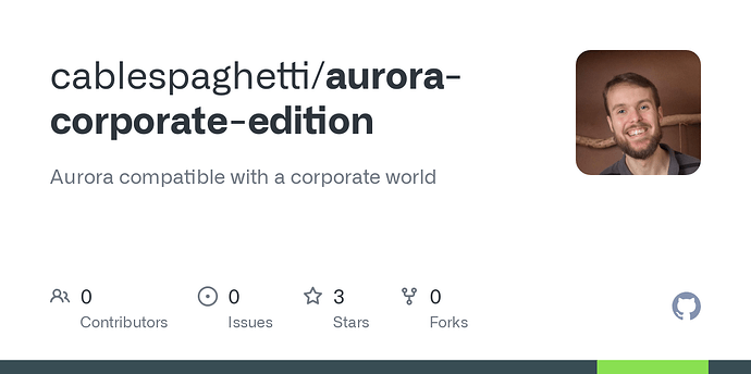

I checked on a random fork from image-template’s fork list, and it outputted a package too:
