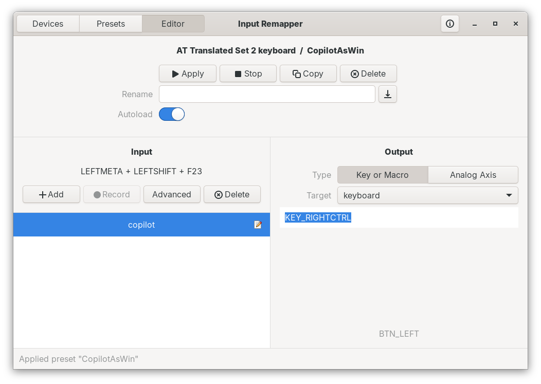

There is a neat app in Bluefin called input remapper which allows you to remap keys. With the newer kernels it it now allows me (thank God!) to remap the “Copilot key” back to the right Ctrl button, as shown here:
