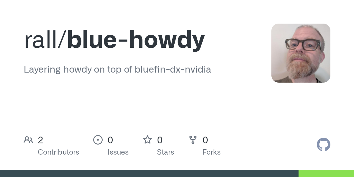

I put this together for bluefin: if you want to try it out I’d be interested in your feedback. Since bazzite doesn’t use GDM I would need to make a few additions to get howdy working on that base but it should be easy enough
I’d be willing to try it out on my Bazzite install if you’re willing to make the required changes.:slightly_smiling_face:
Same, I have a Gnome and KDE install to try it on with Bazzite
