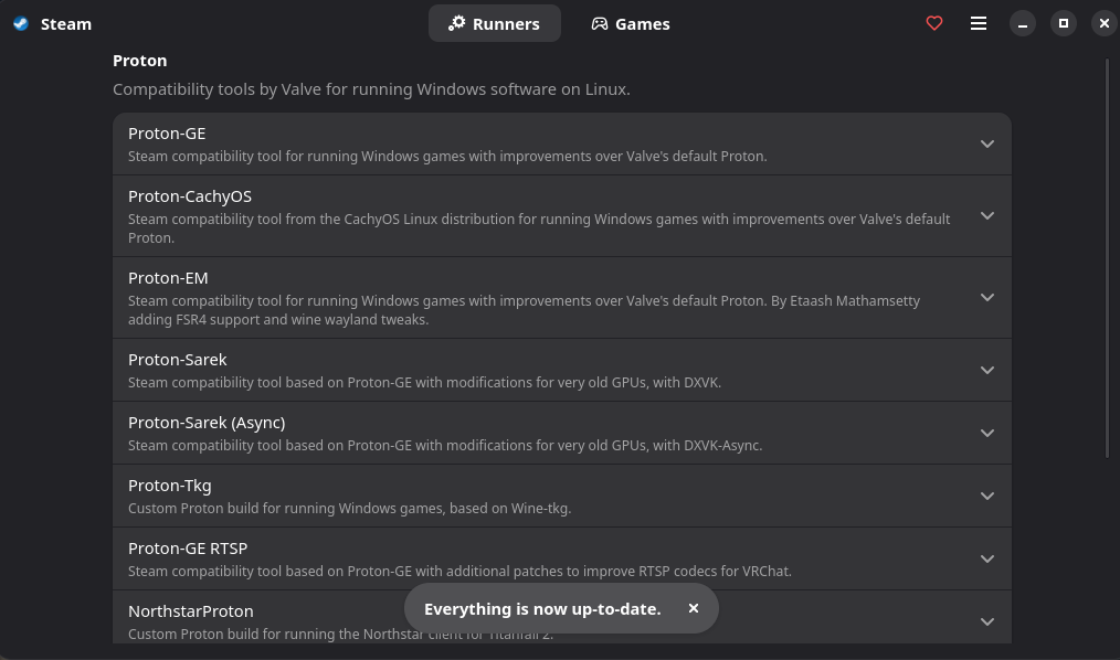

Here a little short veriosion on how i got CyberPunk up and running on FSR4 with just Proton Plus and a command on start up.
PROTON_FSR4_UPGRADE=1 PROTON_ENABLE_WAYLAND=1 PROTON_ENABLE_HDR=1 %command% --launcher-skip
You can skip HDR if you dont have a HDR display.

Proton Plus you can download other proton versions to run you game on.. it adds them to steam so you can switch from GE or CachyOS version.
did not need to add any DLLs in the install directory. Just add the command line on start up in order to get it to work. remember to restart. :slight_smile:

Proton plus is a separate program that was already installed on my bazzite installation. So just open the application and add what ever proton version you want:
