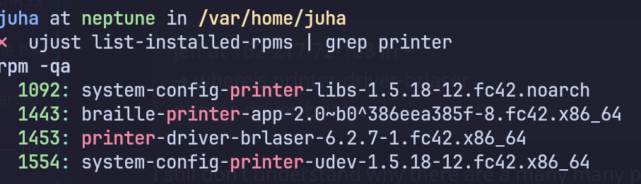

That driver is included in Aurora but no idea what printers etc it support.
➜  ujust list-installed-rpms |grep printer-driver-br
rpm -qa
  1453:	printer-driver-brlaser-6.2.7-1.fc42.x86_64
We had some epson drivers with Fedora 41 but those were abandoned in upstream in Fedora 42.

Interesting that your terminal output lists that Brother driver. When I use the command lpinfo -m I don’t see that driver among the list. Not sure what that means, but my attempts to get KDE and CUPS to recognize a driver weren’t successful, and even my connected printer didn’t show up when attempting to add a printer.

Bluefin and Aurora, both have printer-driver-brlaser included in the image, which should add support for “older brother printers”..
So I am not sure what other drivers should we need.

Inffy: here is the output for the whereis command - it just repeats the command with no additional information. If the driver is there, I have no idea what its location is.
jeff at 162-217-72-138 in ~
➜ whereis printer-driver-brlaser
printer-driver-brlaser:
