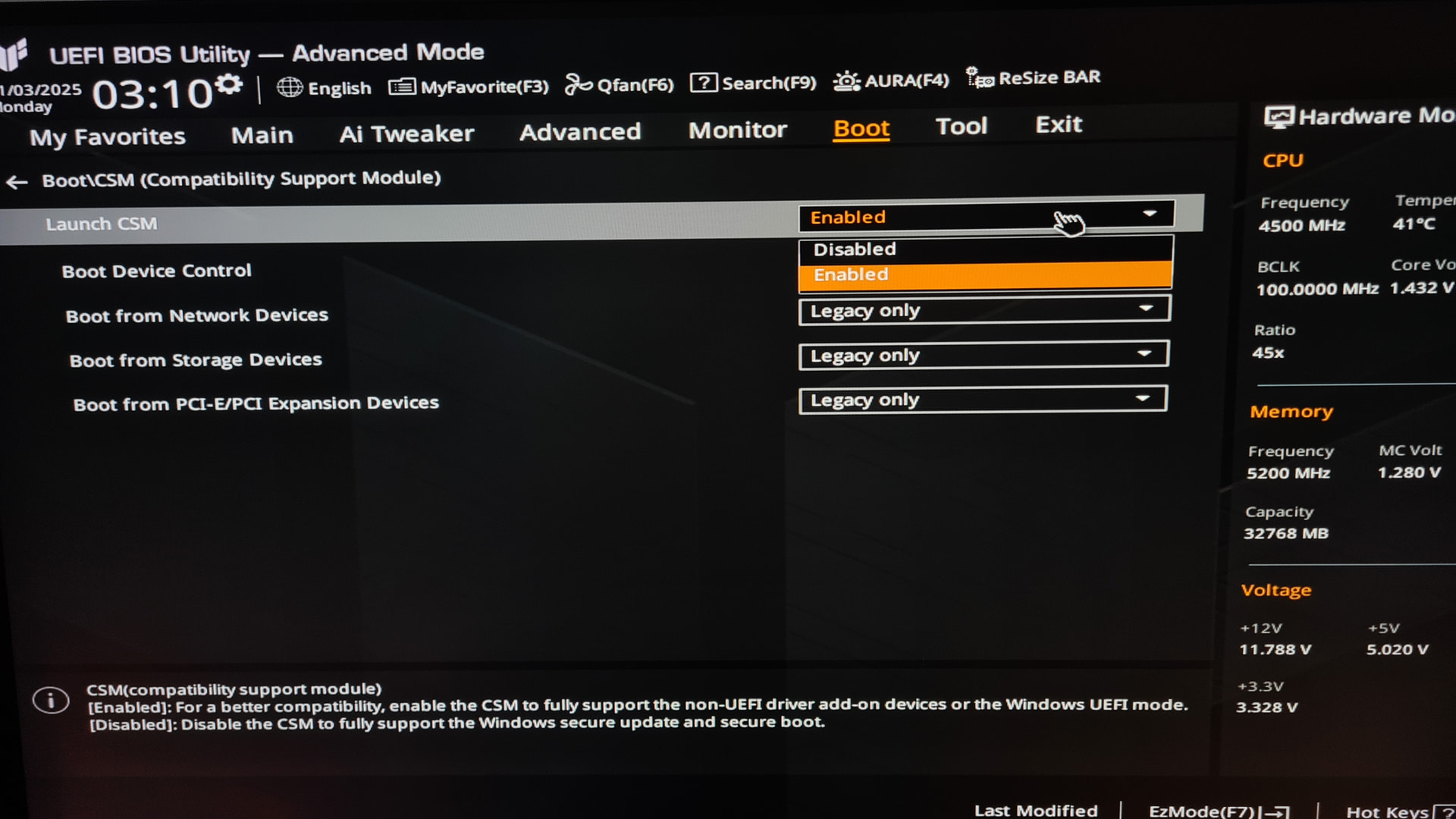

After multiple tries and multiple Linux distros with no success, I tried to install Bazzite again with same result: the monitor plugged in NVIDIA GPU was not working.
Then I went to the basics of the installation: the secure boot.
My MB is an Asus B650M-E and there is no option to disable secure boot. The options are “Windows UEFI mode” and “Other OS”, the last one I figured was the disabled option. And yes, I tried to boot with both options and it did not work.
Then, for the first time I tried to enable the CSM (Compatibility Support Mode), which was disabled.
And that worked!
So for everyone with an Asus MB, it is not enough to change the secure boot to “Other OS”, you will also need to enable CSM.
I hope this tip helps anyone having the same problem as I had.
