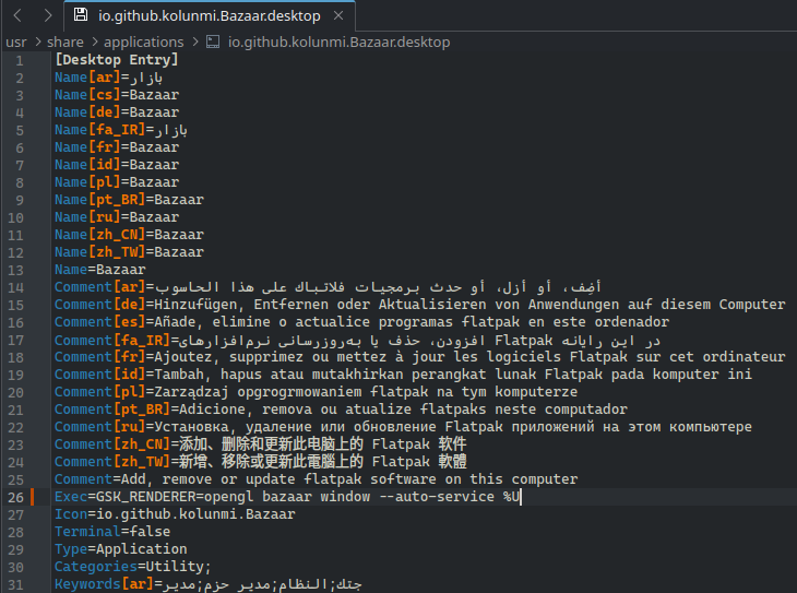

Try running GSK_RENDERER=opengl bazaar window --auto-service and if it works, make sure your .desktop for Bazaar is the same
It does on my end, how does one go about “mak[ing] sure your .desktop for Bazaar is the same,” is it just adding that to the command that runs upon launch, say from the launcher or a desktop shortcut?
Assuming that is the case (t’is what I just did via the KDE Menu Editor) it gives the following as a popup error in the app:
failed to load local flatpak bundle '/home/[USER]/bazaar': Failed to open file "/home/[USER]/bazaar": open() failed: No such file or directory
Adding it as a folder and maxing out permissions results in:
failed to load local flatpak bundle '/home/[USER]/bazaar': Failed to open file "/home/[USER]/bazaar": open() failed: Permission Denied
And adding it as a file instead (no contents in the file) results in:
failed to load local flatpak bundle '/home/[USER]/bazaar': Invalid checksum of length 0 expected 32
If that means anything. None of the above seem to impact performance however, still able to install and uninstall flatpaks, just a popup message that doesn’t come up with Bazaar being launched via CLI.

Yes, I believe you can simply edit the existing Bazaar .desktop file:
Any tips to bypass the read only nature of it? Sudo Nano-ing didn’t work, modifying it as Admin wasn’t permitted, and perms are all blocked out on it itself.
I can also confirm my Framework 13(iirc? Oldest gen) is fine too thus far, though I don’t recall if I updated recently
You can copy it to your /home/$USER/.local/share/applications, then edit it there. In my experience, it usually supersedes the normal entry from the system (at least that’s the usual behaviour when I use KDE’s built-in Edit Applications option in their launcher).
Alternatively just copy it to your Desktop folder in home?
Oh, apparently not only is there a copy already there, but it’s already got the edit made. I assume that’s from the KDE Menu Editor given I hadn’t edited it elsewhere at all. Testing it now, it…
Wait, wrong PC…
Nope, even still, editing in /home/$USER/.local/share/applications, now doesn’t even launch. Here’s how it’s written now, with the new edit in it.

I got it to launch this way. Try this string.
Exec=GSK_RENDERER=opengl bazaar window --auto-service
