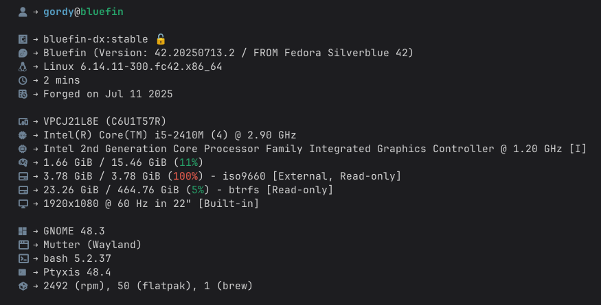

What image are you on? (Need more than the version).
Working fine on all my systems, maybe it’s an nvidia thing? (again)
I am on an intel machine…
● ostree-unverified-registry:ghcr.io/ublue-os/bluefin-dx:stable
Digest: sha256:a31778ab38093cfff4b96c569bbac141682b70fefc9e53eb66e3a0b4e02c3512
Version: 42.20250713.2 (2025-07-13T06:05:44Z)

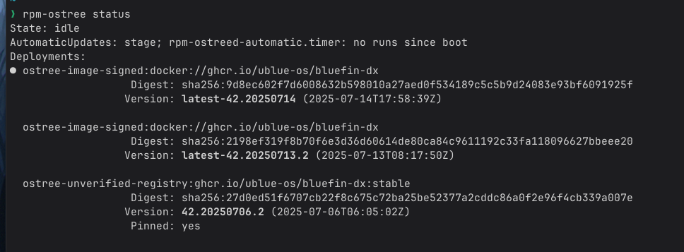

If any of you are on :latest or able to test we think we got it. Once we have confirmation we can push the fix out to stable, thanks!
still not working for me it just opens a blank box and crashes.
Gordy.

We need folks who are experiencing this to try in bluefin:latest, instructions here: Administrator's Guide | Bluefin
OK we got reports that this is fixing it, we’re pushing out new stable builds now, will go live once these are green, keep the reports coming please!
Hoping the same will be rolled out to the Bazzite builds where i have the same issue
