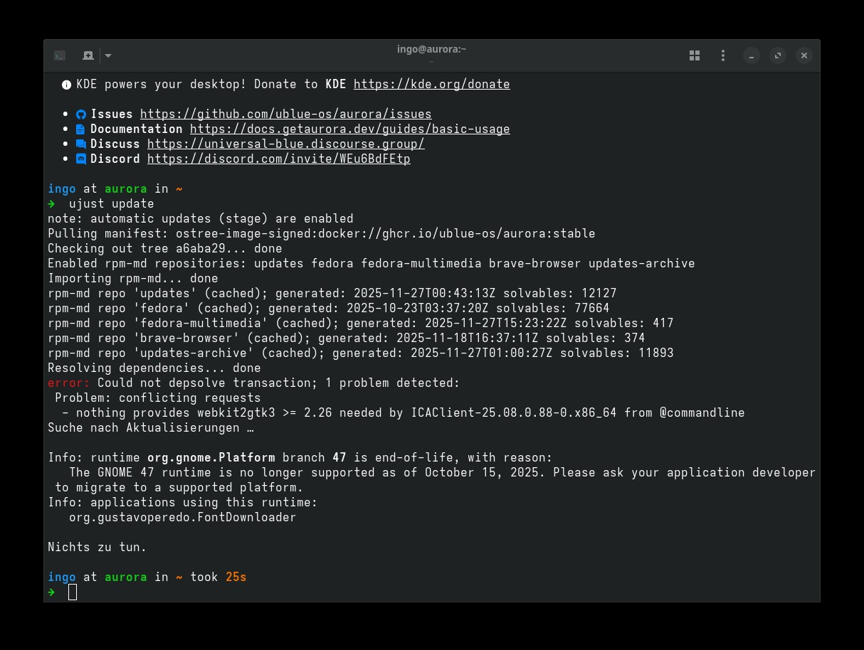

I´m on the stable stream with Fedora 42 - is Aurora automatically upgrading to Fedora 43 or have I change the stream to an actually version ?
(Or: can I upgrade manually ?)

All updates are “continuos”, you should already be on F43 unless you have somehow blocked updates (or the background update hasn’t run).
You can also manually update by runnin ujust update
yes you have layered something which breaks the update.
You need to remove them rpm-ostree reset, then update and if you need those install them back. But i would recommend to try to get them working withouth layering, maybe through distrobox
