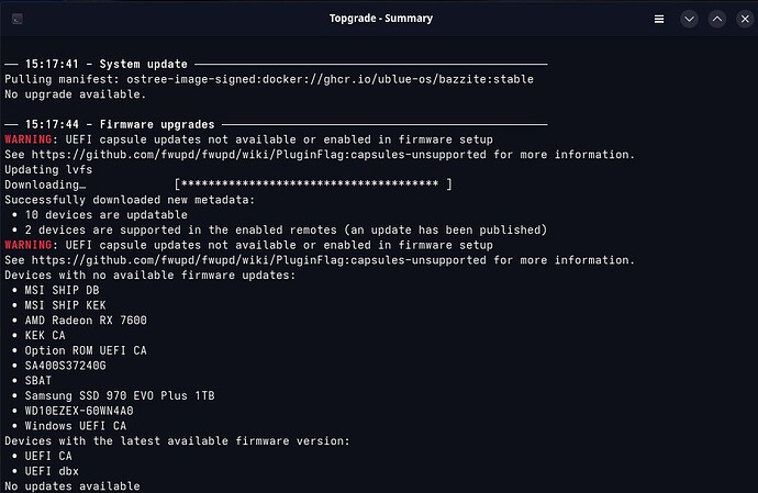

Today I had the following:
This syntax is totally new to me. Does “10 devices are updateable” mean there are updates for them available; or does it simply mean “you can update them if an update is ever released?”
About the second part where it says “2 devices are supported in the enabled remotes (an update has been published,) does it mean there is an update currently available? I am checking the Firmware app and there is no update available there.
Long story short, I have no idea how to interpret frmupdmgr. I don’t know if it actually updates anything at all, because so far I had to use a GUI app to update firmware. Language used isn’t clear and I am confused.
Thanks for any replies in advance and have a great day :slight_smile:
It lists the “metadata” for devices that have been added to lvfs. Then it checks if there are support for updating them through.
All of this prtetty much depends on your manufacturer, do they provide updates through lvfs (most don’t).
you can see if there actually are update with
sudo fwupdmgr get-updates and then run sudo fwupdmgr update to install them (if there are any)

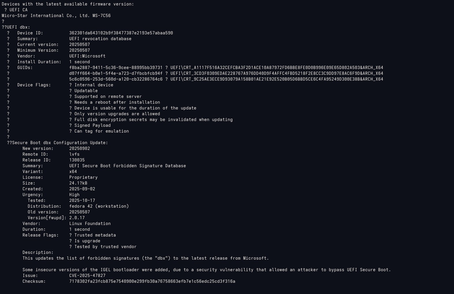

One more question. Does the Firmware GUI app use the same method as the CLI? I am asking because of this issue I had about a week ago:
Why couldn’t System Update apply this new firmware, for example? I had to use the GUI app to actually install the firmware. My concern is, a regular end user expects System Update to perform all updates and it gives the impression it’s applying updates while all it does it state if there are new updates or not. If I hadn’t come across the GUI app by pure coincidence, I wouldn’t be able to install these firmware updates.
Maybe you could include the GUI app in the image for future builds and direct users to that? If I’m sounding off the mark or dumb please let me know :slight_smile:
Determining the default apps for a distro is always a tricky decision, but agreed this one would be nice to have.
That said, the GUI GNOME Firmware app does use libfwupd under the covers, and is also written by the mighty Richard Hughes.
