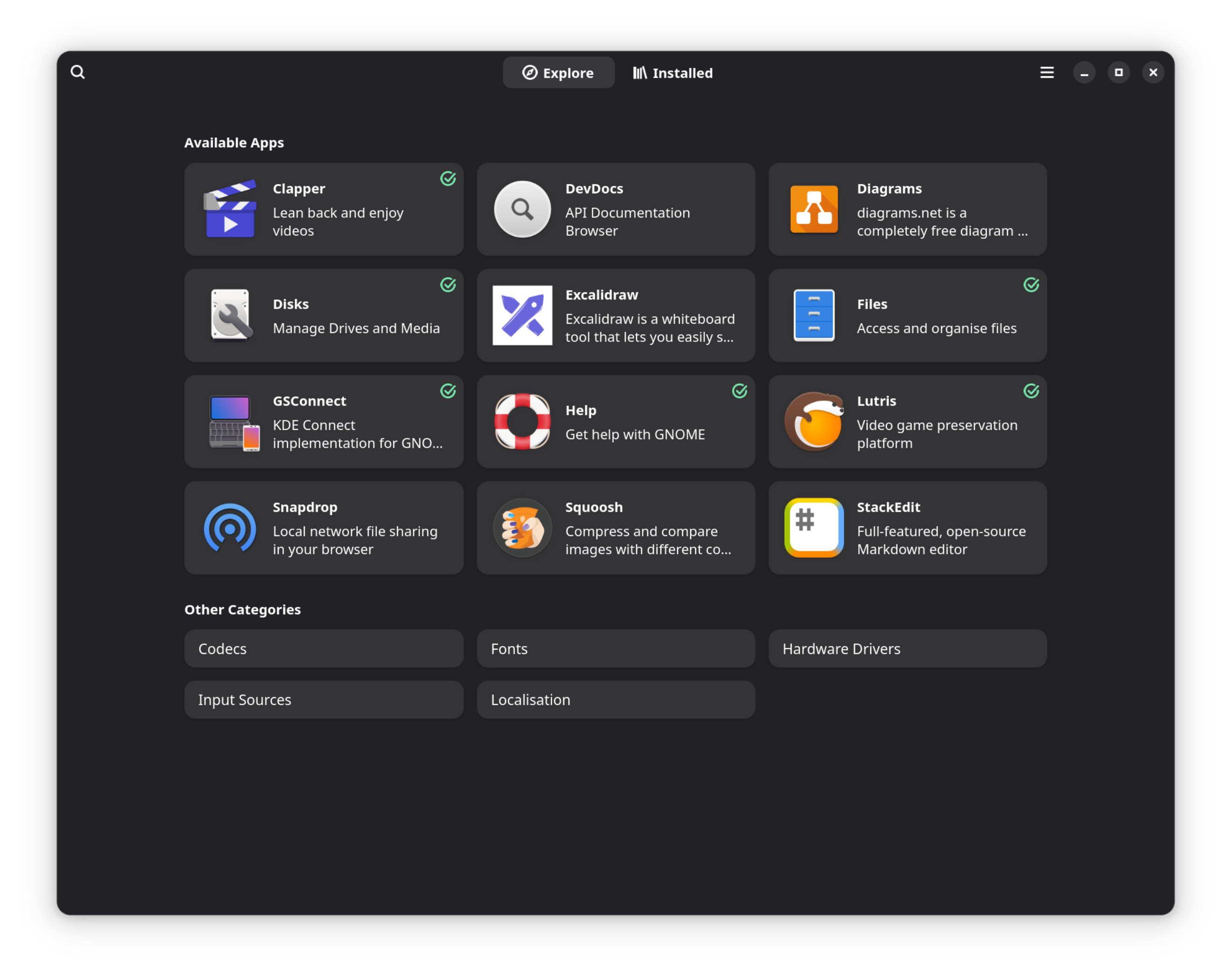

Hi everyone!
Recently I’m having this issue with Gnome Software where i can’t search software to install :confused:
(doesn’t show banners or other applications)
And if i search for applications :backhand_index_pointing_down:
No App Found
I’m currently on Bazzite 42 :stable
How can i debug this?
Thanks in advance,
Regards.

Thank you for the hint!
As you said maybe the application was corrupted.
A rollback didn’t help so i tried to change branch (went to :testing using bazzite-rollback-helper rebase) and this did fix the issue!
Now i’m back to :stable and Gnome Software works fine!
Thank you again @svnskr
