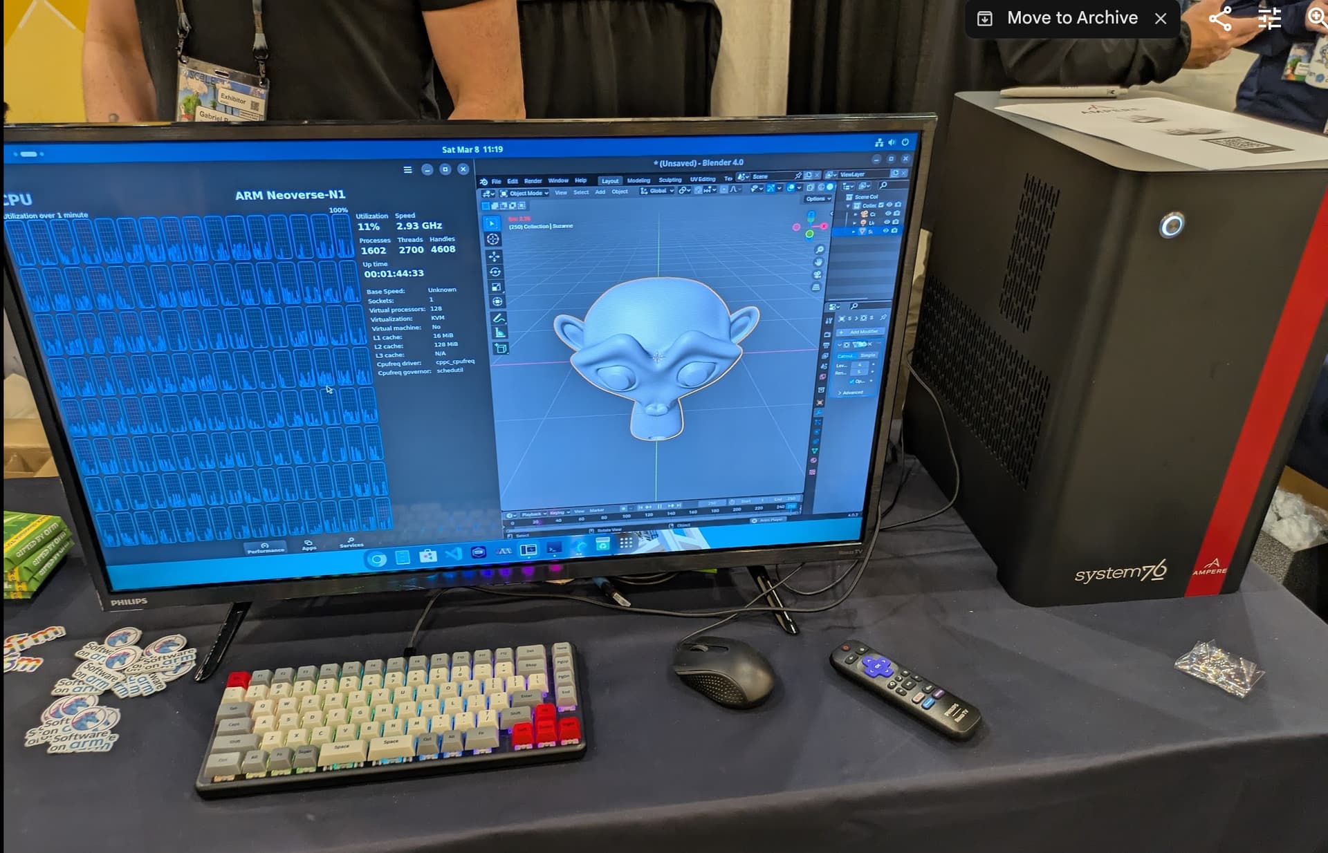

Hello from the show floor at SCaLE! Here’s Bluefin GDX on a Thelio Astra. 128 delicious Ampere cores. :smiley:
TONS of great conversations with the CentOS folks, specifically in the Hyperscale SIG. We are pretty much set to start consuming newer kernels in the optional hwe images and there are plans for backporting GNOME back to CentOS 10. All in all I think we’ve checked every box.
