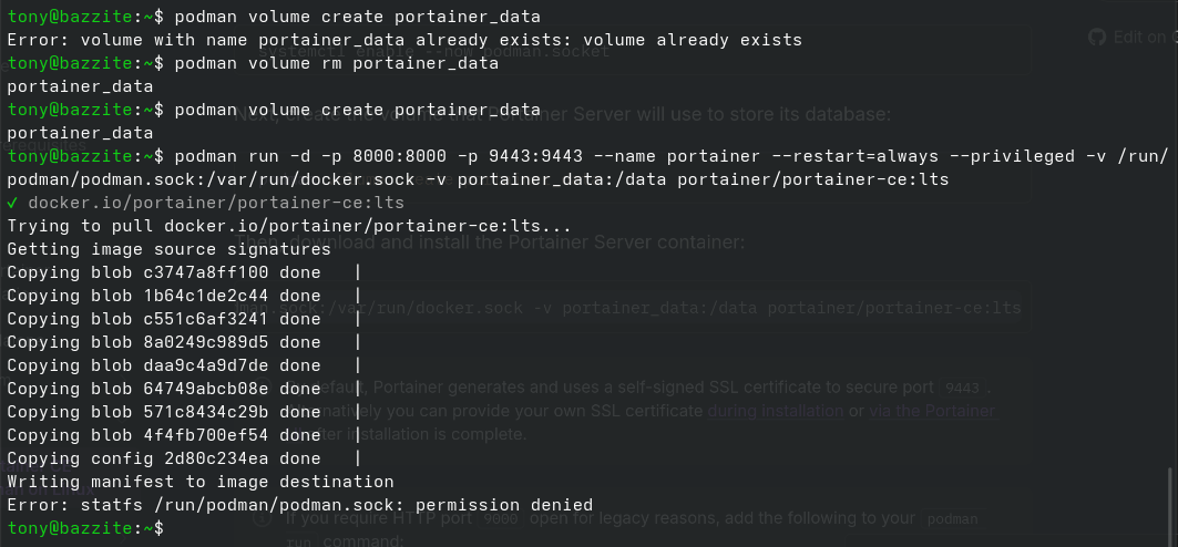

Tried the thread and got stuck here instead :confused:
Tried following the official Bazzite tutorial but replacing it with the Portainer one and that didn’t help at all
