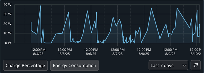

For what it’s worth this was what the KDE monitor showed as my power consumption for the last week. This is just with video playback, remember. I have no idea what’s causing those weird spikes.
