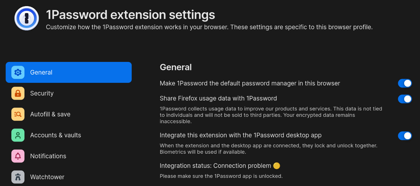

I’m trying to install 1Password on Aurora and have it integrate with the Firefox extension. The .rpms were downloaded by adding 1Password’s own Fedora repo.
The desktop app works great via distrobox, but the browser extension does not. The integration fails with a “Connection problem :yellow_circle:” message in the extension’s settings.

I guess I don’t understand the problem. I use the 1password official flatpak and the official 1password plugin with Firefox without issue.
Yes, both work, but they do not work together. Does your browser plugin say “Integration Status: Connected :green_circle:” in its settings?
