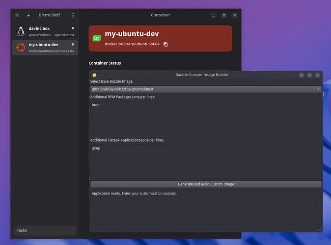

Okay, I started to look into this, and I know I can just go on github, copy the template, and carry on as the documentation says.
I was wondering though about making a GUI for those steps (which would include also signing the image eventually).
I started making a very rudimentary app with the bare bone options which allowed me to make a local image in podman.
I still have to check that the image functions correctly, but I do have 12 GB worth of image sitting on my PC now, so it managed to build something :stuck_out_tongue:
I’ll probably install it on a virtual machine to see if it works, before I start looking at the signing and Github integration. I also need to make sure I am actually pulling from the template.
This might be a fool’s errand, but I just wanted a GUI, maybe if successful it can help other people. If not I will have learned some lessons.

So! I have made my first image after bashing my head against a few walls, but I think I am starting to get the hang of it. I also discovered I rather do it via terminal with the method outlined in the Ublue Template.
  1. I temporarily fixed the problem with KDE’s Google Drive integration (by using the GNOME API) I saw in the KDE forums that apparently they don’t have a maintainer for that, maybe at some point I can reach out to them and see if I can help them with that and get their API to work (if no maintainer, maybe they can’t reach who set up the API?); I won’t keep using the GNOME API, I was just trying to see how to make the fix work via making my own image
  2. I also added a “install-my-flatpaks” ujust script as a test, with Discord, OBS and Mangojuice, as I feel will be relevant to a lot of gamers (especially Discord and Mangohud), and OBS if they stream on Twitch or record videos for YouTube (as I do occasionally), potentially also stops requests for Goverlay;
