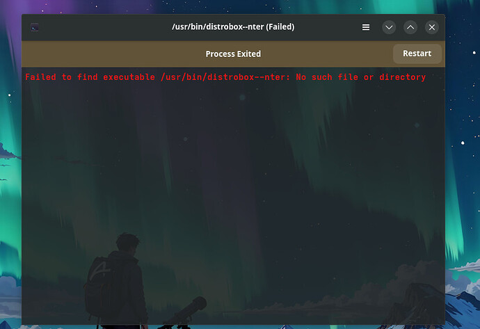

Noticing that nethack was not installed, I created a fedora distrobox, installed nethack with dnf and exported it successfully, but when I tried to run nethack from the menu I get:
Any idea why this is happening?

that error comes from a bad path in the desktop entry: something (export, editor, or copy/paste) turned part of the command into weird dashes and mangled distrobox-enter into distrobox–nter.
yea, trying to figure out why. It’s strange.
I think the app launcher broke because Unicode “smart quotes / smart dashes” autocorrected the command line, making the path invalid. Have you been able to reproduce it?
I had the same problem a while back. I ended up changing the command line to /usr/bin/distrobox, and putting -enter in as part of the command line argument. Or something like that. Don’t remember exactly.
