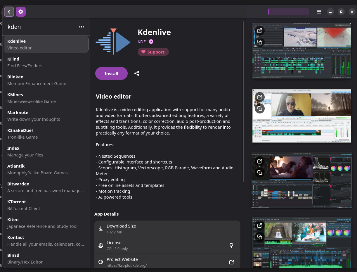

flatpak install appname
to install things. In this case, try “flatpak install kdenlive” and see if it works.

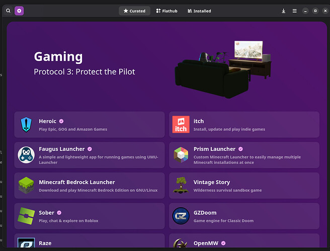

You might think it has nothing to do with bazaar, but if possible, run
rpm-ostree reset
to reset your system and try and see if Bazaar works that way. Honestly that’s the only thing that comes to mind at the moment.
Also, googling gave this result:
“OK, I fixed the problem. Apparently I had some other flatpak repo’s installed in Warehouse. I deleted them, and Bazaar works now. Not a fan of this new app store, but then again, I hardly use it.”
So if you have any other flatpak repos installed, I recommend removing it.
